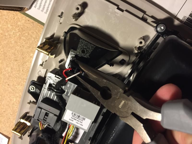

So to me the one thing this thread is really missing is some install pics. It is a very easy mod, but if you're like me, you want to see pics. I hope these help someone out.
I bought what mbucklein directed me to on Page 8 from superbrightleds.com. The only change I made is I did not buy the brighter more expensive LED for the glove compartment because I didn't see the need. I only bought two of those for the trunk space.
What I used was a trim removal kit and a small flat head. If you don't have a kit get it on ebay for a few bucks. Well worth it

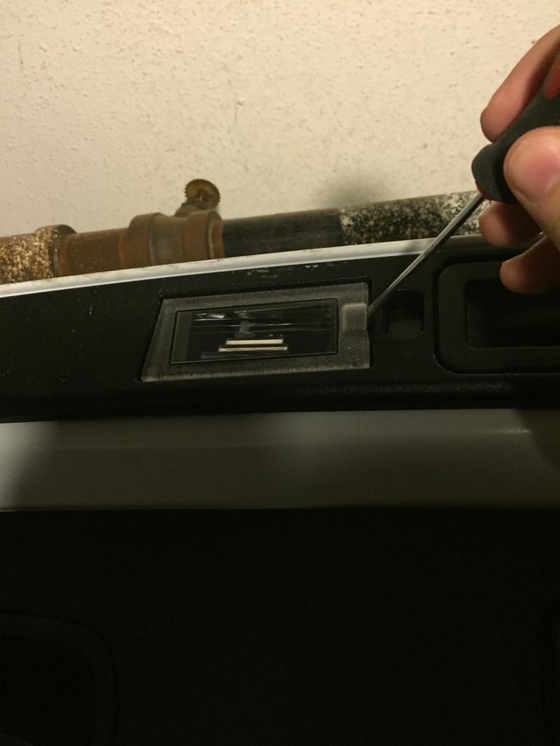

Trunk removal tips- The screwdriver is inserted towards the front of the vehicle. (Pic is with LED in)
Trunk old light
Trunk LED

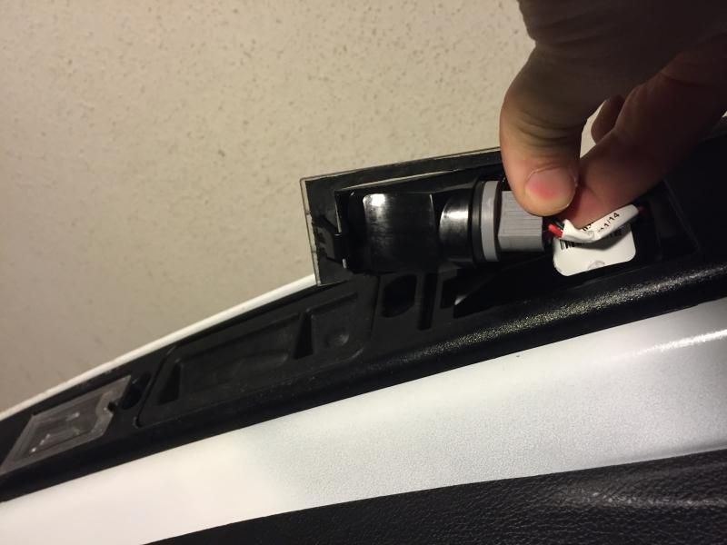

License Plate - I do get the license plate out warning at start but its literally 3 seconds
Give it a slight turn, pull out bulb and replace
Old on the left, LED on the right

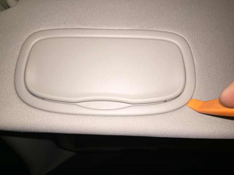

Vanity- Found it easier to start on the side and work my way around
Old Lights
LEDs

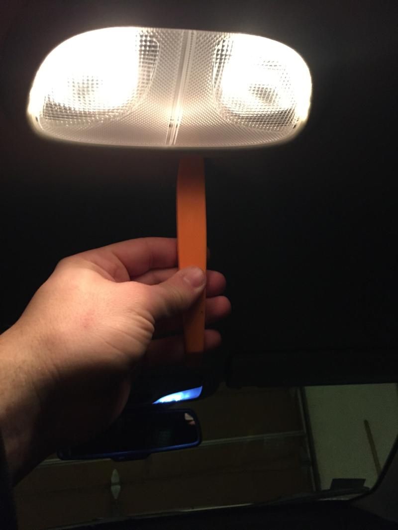

Dome removal start towards the front of the car, work your fingers under and pull down
Unclip here
Give a slight twist, remove and replace
Map removal- make some space and pull down from the front of the car
Once you unclip it, remove bulbss by pinching housing
Map LEDS
Dome old lights, Maps (Front) LEDs
Glove compartment you just use the screw driver and wedge the right side out I think
How did you manage to take off the bulbs in the vanity?
Stick a little flathead screw driver between the lense and mirror and pull up and away from the mirror (maybe the otherror side I can't remember). Needle nose to get the bulb out. I had to file my LEDs down a little bit until I could fit them.
Sent from my iPhone using Tapatalk
Small pair of pliers. Got as good of a grip as I could and just pulled.
