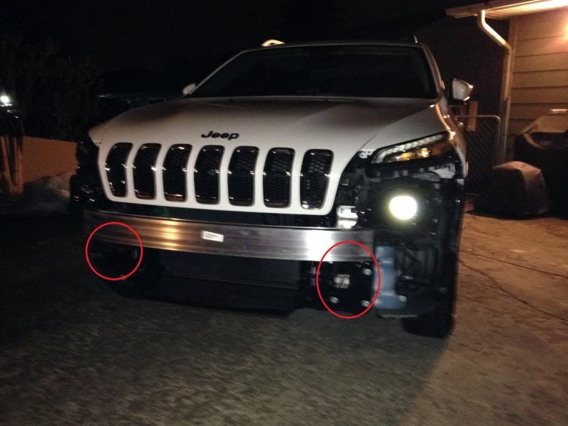

Originally Posted by tartagliag View Post
Yes, if I remember correctly, the steel beams (which receive the steel bars for the tow hooks) are pre- drilled with holes in them? I guess where the bolts are supposed to be installed.
If you put these hooks, you will have to order a new front plastic cover, as the plastic panels where the tow hooks are can't be removed on the Sport model.
tartagliag
This is a terrible picture, but I have had the whole front bumper of my Latitude (looking to add tow hooks) and there are pre drilled holes already in the square metal tubes. Looking closer it actually seems like the Mopar Tow Hook Kit for the 2011+ Grand Cherokee's for $168 will work on the Cherokee's just need to match up the holes, but based on a tow hook off of a TH, the look identical to the GC ones... Might have to make the purchase and see what happens! The kit is WAAAAY cheaper then buying the 2 TH tow hooks for almost $500, plus still needing the brackets and hardware... Ughhhh....
madchemist24 likes this.
Was it difficult and time consuming to remove the front facia and bumper? Is it a matter of removing the black "clip on brackets" or it there other bolts to remove?
Thanks
Tartagliag
